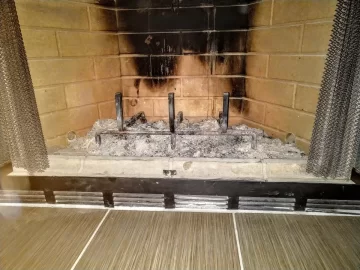

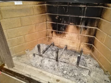

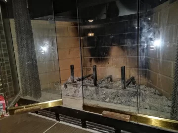

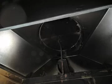

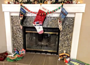

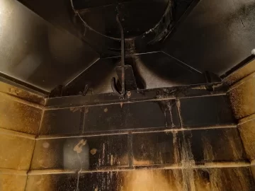

Hi Everyone,
I joined this forum back in 2013 when I installed my very first wood stove. Sadly, I only got to use it for 3 seasons before we ended up moving from SE Mass. to Southern AZ back in 2015. Now, 5 years later, I want to get back to wood heat! I will only be wanting to burn for Dec and Jan due to our mild temps. My AZ house has an open small fireplace kit back from 1987 (instruction manual hyperlinked) when the house was built. I have attached some photos. I am wondering if I can get a woodstove insert installed in a fireplace kit like this. Please share your opinions. Thank you in advance!!!

Nope the introduction clearly says you cannot modify the fireplace in anyway or use any components not manufactured or approved by fmi for use in this fireplace
I see what you are pointing out in the instructions. I was trying to be optimistic since the language says modifications "may" cause a fire hazard. Have you heard of anyone attempt a fireplace kit to insert conversion?

Thank you, I do like the look the the fireplace and mantel. We have a small-ish home so, I don't think there is another good place. It is a shame if we can't use an insert in the fireplace since it already has a chimney.
Yes and with that statement in the manual it would be a clear violation of code
Ok bholler, I appreciate your firm stance here but I did find a old 2013 thread that presented some differing views, making this seem not quite as clear cut here, Insert in a Prefab fireplace - help needed on options | Hearth.com Forums Home - I actually found your comments on this thread helpful on understanding who hold liability, namely the installer.
Yes the liability incase something went wrong with the completely untested and against code install would fall on who ever did the install. But the risk of life is on you and your family. We simply have no idea at all if doing this is safe. No one does that fireplace was in no way designed to be used in that way.
Even if it was permitted your fire box looks shallow and the flue looks like it is pretty clos to the back wall that will really limit you on insert choices. It would have to be a small insert I have some experience with inserts under 2.0 cu ft I don't think its worth it. My dad and brother uses Buck 18's constantly loading them glass turns black quick, little heat output and short burn times. If it was me I would remove the mantle remove the ZC and and put in a high efficiency ZC like Pacific Energy FP25 or FP30. Reviews seem to be good on them it would be much safer more than likely look better depending on clearance maybe able to re use your mantle.

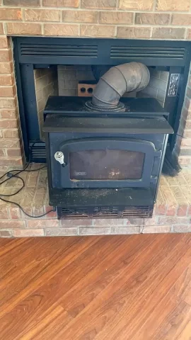

This guy had the same problem you do[Hearth.com] I am back and want to burn!
This guy had the same problem you doView attachment 268139
That guy has a lot more problems than he does with that hacked install. Great hearth protection too.
However, it might be worth considering a rear vent stove with a liner.
