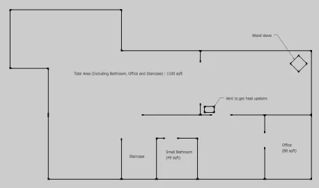

Here is a floor plan of the first floor of our house.
The house was built in 1997 and is well insulated. The location of the stove is really not ideal but we won't change it. It gets hot in the room where the stove is located but it's manageable. The first floor is 1100 sqft and the second floor as well. The second floor gets heated over the course of the day through the vent and staircase. It remains colder upstairs but with all the room doors open, still comfortable.
