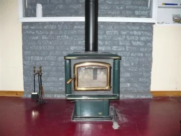

The house I am buying has a Pacific Energy wood stove thats in pretty good shape. It has a nice chimney and everything is mint.

The stove is a Pacific Energy something.. it was installed in 1998, I don't know the dimensions off hand..
I have no idea if its even big enough to heat the house

Is the existing stove in the basement or upstairs?
Where would you be spending most of tour time?
How much effort to move the stove upstairs and tag the exisiting chimney?
