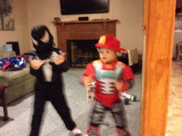

The fireplace is masonry. That was the only picture I have of the fire place! Dont mind my kids!! I would like to spend 3000 (installed). That seems impossible around here. I have attached the only picture i have of our fire place. The plan was to use the fireplace to house the wood stove. We obviously would need to extend the hearth. The opening is 36 inch wide and height is 30 inches. I am looking for more pics of the house. will post soon. My husband just went to a dealer near here and was recommended the Harmon Oakwood. Would be 3800 installed.

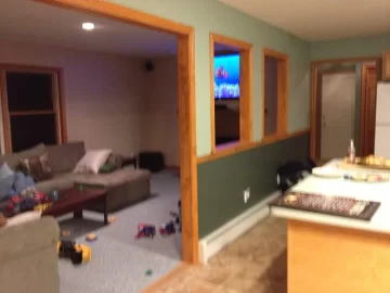

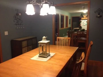

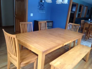

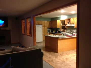

Here are some other pictures of the downstairs to give you a better idea of the layout. The stairs to the second floor are on the side of the house behind the couch

I think some of it is personal preferance as well as what is existing. Since you have the fireplace opening an insert is probably the right direction. Be aware that you need to line that chimney all the way to the top. Don't let them just put the pipe partway in there.

A rear vent stove will allow you move the stove out farther into the room, depending on how far you want to extend the hearth.
Your wood mantel might be an issue.
Hard to tell looking at it, but if you do a freestanding stove, once you extend hearth and side clearances it may take a rather large chunk of space in that room. I prefer freestanding myself but there are inserts that are pretty darn good out there.
You may want to do a mock-up with a box or two to set in the room with required clearances/hearth marked out on the floor (we used some large pieces of paper to mark ours out). This will help with your ability to visualize how much space it takes (i.e. you can't stick a dining room chair or couch inside the clearance zone...)

Couldnt the stove be set into the fire place slightly?
If I was starting over today and with the choices on the market now I would be looking at a free stander, you're going to have to extend the hearth either way and line the chimney either way. You are somewhat limited to rear vent only free standers but I think you would get more heat.
