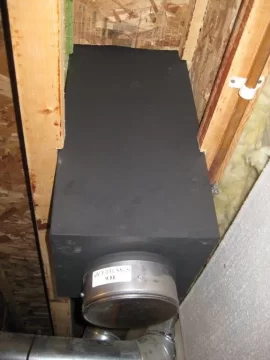

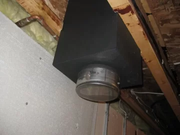

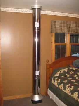

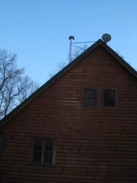

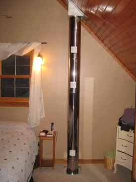

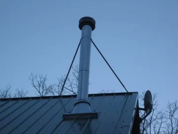

First step done. Chimney installed....now need to box it in and do the finish work. It's all Excel chimney. TGI joists are 12" O.C., so luckily Excel uses a 10"x10" support box.

Just a thought: watch your clearances on the stove pipe to support box connection. definitely need double wall pipe in there.
also, that's the nicest roof flashing for the pole barn steel roof I've seen. did you buy that somewhere or have someone fab it up for you? super slick.

yep, we are right at 6" clearance....which is required even for double wall pipe. The poured concrete walls have Styrofoam insulation on both sides which doubled as the form when the walls were poured. I put up some cement board as a precaution, so what you are seeing in the pics is the cement board.
The flashing is Excel's flashing made specifically for metal roofs. It was another selling point on why I chose the contractor I did, as they only install Excel chimney's and they told me they have contractors buying this flashing from them for their install's on metal roofs. They told me it's pretty much the best metal roof flashing you can currently get...or at least that they've seen.
