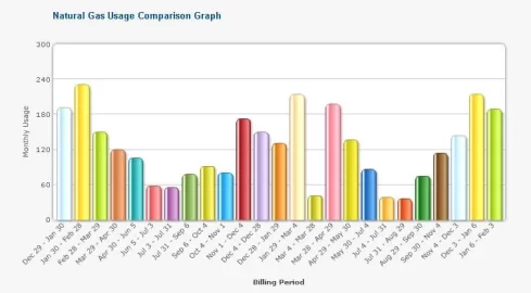

My Winter bills are roughly three times as much as my summer bills but the Spring and Fall bills spike cuz we let the fire go out. Basically the furnace component in Winter adds up to about $2 a day. Here is a graph the gas Co. give us to chart usage. It's a bit skewed some months cuz they often estimate and always on the high side.

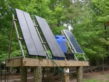

You could build yourself one of these to stick on your roof--re: to preheat the water before entering your hot water (or cold water) heater. This is what we use at the Environmental Education Center I work at to teach students about things they can do at their homes to reduce their "carbon footprint". It's a simple design and although we incorporated a solar panel, you wouldn't necessarily need to do that. The solar panel charges the battery that powers the pump. The pump draws water (at 56*) from the 55 gallon drum (we have our well water plumbed directly to the 55 gallon drum) and circulates it through the copper tubing inside the black metal boxes. Once through the metal boxes, it re-enters the 55 gallon drum. If you run the system for about 20 minutes depending on sunshine and air temp, you can raise the water temp to well over 100*. Eventually, this system will also serve as outdoor showers for the staff.

I sent you a PM about your panel. I have been interested in building one for a while.
