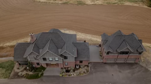

We bought what was going to be a winery with living space above it...it is a BARN. Located just West of Salem, OR, Mid Willamette Valley. Vineyard country. We bought out of a divorce/bankruptcy situation. We got the property for about 25 cents on the dollar over what just the land is worth...my guess is they lost their shirt on this property and that is why they never finished it.
Specs:

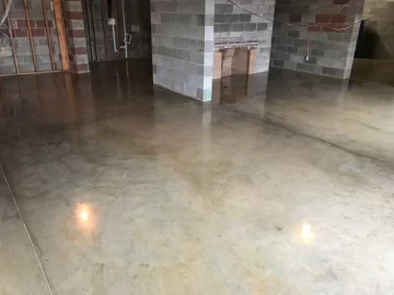

Basement- 2000 sf, buried on 3 sides, this was going to be the production room and tasting room. Concrete floors with insulation, 10 ft under grade, 11-foot ceilings, piped for radiant heat (tubes in but they never finished the install of the pump and heaters

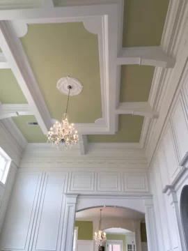

Main Floor- 1700 SF (great room has something like 21 ft ceilings)
2nd Floor- 2000 SF (4 of the 6 bedrooms are here)
3rd Floor- 300 SF (1 bedroom)
Total SF= 5000 SF
There is also an unfinished garage (separate structure) that we will eventually be finishing into a 2 bedroom apartment that is another 1150 SF

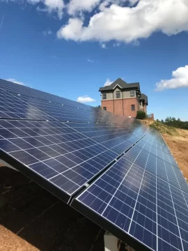

The home is all electric except for propane for the cooking range. We have a 22.4 KW solar install as well but the bills in the winter are north of $700 regularly. I have JUST done a lot of energy upgrades but my guess is heating and cooling are still going to be BIG bills.

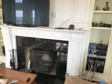

2 fireplaces (one finished one not) separate flues. Not sure on the chimney, but REALLY tall...my guess is the fireplace in the basement has a 40 foot plus strait run and the one on the main floor 30".

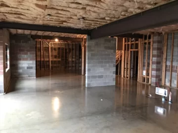

Fuel: My family owns agricultural land nearby and on this property, we have a LOT of Oregon White Oak, Hawthorn and Cherry that we can burn. I have probably 10 years worth sitting in burn piles waiting to be processed that we cut a year and a half ago. Cutting wood is a great job for me, I love it as it gets me outside and I have help if needed (good time with my pops etc.) We also have neighbors we trade with, we let them cut and process the wood and we take a share and they take a share, win-win.

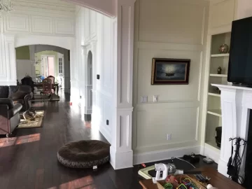

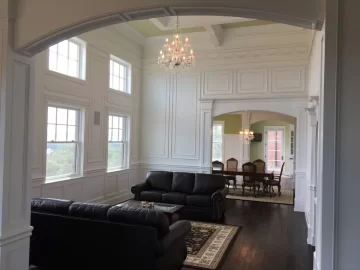

My thoughts are to do something like a Woodstock Progress Hybrid in the main floor as it would match the style of the home. I will confirm the dimensions of the fireplace and get those posted it is the finished one in the pics.

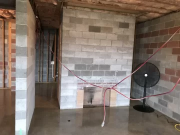

In the basement, my thoughts are an insert and run that to spread some heat to the 3 floors above it as well as the basement.
I know that thing really needs a wood boiler, there is not a place outside to put it (we are on a steep slope, have vineyards all around and the couple of places it could go would mean it was venting right under 3 floors of living space and patios. There is a possibility of an interior one venting into the chimney for the basement fireplace (it is fine if we lost that fireplace, maybe we throw an electric fireplace in there for the look etc. I am attaching the basement layout in case anyone wants to take a look at that. The TV room is silly and we would use that as storage or wood storage etc. Also attached are pictures of the basement, main floor, and the house exterior. We have a large area that was going to be a wine cellar that I can have wood inside as well as “maintenance” room under the front patio that we just sealed in that is 15 x 20 with 11-foot ceilings, all concrete so I have room for wood storage.

The PH would look nice there, though the hearth may need extending. How large is the room? Is it very open to the rest of the house?
That's a beautiful spot. Have you considered subletting it to a winemaker of merit? The wood heat would just be supplemental, especially during colder weather. The insulated ceiling will keep most of the heat generated by the insert in the basement itself.

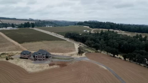

Thanks! Yeah, it is a pretty special area....I worry I bit off more than I can chew but it was such a good deal vs what the actual cost was to build it.
To answer your question about the main room fireplace, if you see the picture of the back of the couches and the really tall room, that is the view standing directly in front of the fireplace. It is pretty open and the air return for the 1st floor is in that taller room. Getting the air through the arched doorway to go up the stairs is another matter though. I have been digging around on the boilers thinking it could run the water for the radiant heat in the basement and maybe connect into the ducting, but there is one system for the main floor and another separate one for floors 2 and 3
I love that area. We've been to the east of Salem a few times to visit Silver Falls State Park. Some of our favorite wines come from the Willamette and Umpqua River areas.
Water to air heat exchangers are pretty common on commercial systems. My sister's house has this. They are connected to a multifuel boiler (oil/wood). Looks like there's plenty of room in the basement for setting one up. If you want to explore wood-fired boiler ideas, there is the boiler-room forum here.
Awesome @begreen We are right on Bethel Heights Rd, by Bjorson, St Innocent, Domaine Serene, Zenith, Cristom etc. Silver Falls is a great area. My dad lives in Mt Angel so we go up there all the time.

Good points. It's one thing to be enthusiastic about buttering your own bread but when you have to butter the whole loaf it's a much bigger commitment. Be sure to realize that every stick of wood you burn is that much less electricity you must buy. So you can partially heat with wood, just as much as you want to and then let the central heat pickup the slack.
Wood or even pellet boilers are insanely expensive and complicated to set up. There is likely no local expertise since it is not common to heat with water in our area.
If you wind up doing inserts, plan in advance how you will install a damper on both. You will need to rig up a control for the thing that you can operate from the outside of the fireplace.
I think you will wind up pulling the inserts to add a damper otherwise with 30 and 40 foot flues.
Consider extending the hearths and adding freestanding wood stoves in front of both fireplaces. This will get you bigger fireboxes, more heat, and less damper hassles.
If the place is currently heated with electric forced air, consider an add-on wood furnace. That would be significantly less hassle than two stoves.

Having $700+ power bills while also having a 22kw array seems to me to be waaay high electricity consumption. What exactly do you have for existing heat pumps? They must be very inefficient, with strips running near constant. Or is it a lot colder there than I am thinking?
The arrays may not be producing much power in NW winter conditions.

You can do a stove or insert on the main floor in the fireplace or in front of it, and that will help with the main & next floor up.
Those ceiling are fkn high! A lot of heat is going to get trapped up there. Maybe you can add transoms to the doorways to allow the heated air to travel horizontally and possibly upward at the stairs. Not sure of your feelings on ceiling fans, but they would certainly help move air around.
