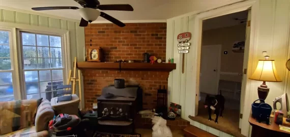

I have a 2 story house with an attached den that would be a garage in most houses. In that side room I have a free standing fisher grandpa bear stove feeding into an open fireplace through a steel surround, kinda slammer style. It works really well to get that room to over 100 degrees. I have to set up a fan system all through the house to try and distribute heat through it. The fan noise is really annoying! This chimney also has a poured concrete liner. It drafts like a monster!

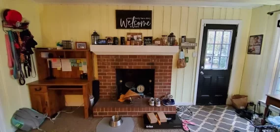

I also have an open fire place on the other side in the living room. I want to take my parent's old Buck stove and put it in that space. It's in the main part of the house so it should do a much better job of heating everything up. This side is a regular clay lined chimney that looks like it has barely been used, or at least cleaned often. I guess would have to drop a liner in.

The problem that needs solving is that the fisher creates so much heat that I can't get out into the house properly. There are no rooms above the room it's in and the massive brick fireplace prohibits putting vents into the living room. I don't know why it ended up this way but someone spent a lot of money to do it.
Excuse my messy house, but this is what I'm working with.

Is this a prefab, zero clearance fireplace with a metal chimney or a full masonry fireplace and chimney?

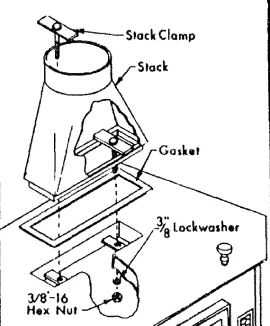

These days inserts requiring an 8" liner are rare. An insulated 6" liner covers almost all. The old Bucks usually have a rectangular opening that needs a transition piece to 8" round. You need to factor in the height requirements for this transition piece and make sure there is room. Given those issues, it might be worth considering a more modern insert.

Right now I think I might see about swapping the two stoves. Put the big Fisher in the den and shorten it so it's just sitting on the balls, that way I can push it into the fire place some and not be in the way as much as it is now. Just 90 it up and out and put a new damper on it.
I think that's probably the best bet, even though I was always happy with the Buck stove growing up the Fisher will always put out more heat.
