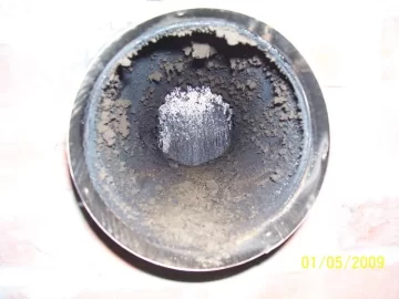

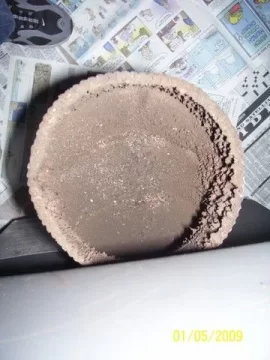

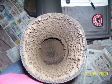

I was up on my roof today and decided to pull my cap again and see what my chimney looked like.
I was just up there a couple of weeks ago and decided to wait on a cleaning as it looked fairly good...
but since then I started burning a lot more of my Ash tree that I took down in Aug. It was split and stacked
in a windy, sunny area of my yard and it burns better than some of the 2 year old wood that I've been using
this season. It lights up like a mofo when I throw it in the stove but... I don't have a moisture meter and won't
be getting one soon as I am temp. laid off right now.
Anyways, the flue has a black sheen starting to develop - not the dry creosote that I usually see - the shiny
stuff - although there is no "buildup" - just a super thin layer on some parts of the flue. I will take pics of the
flue tommorow but it concerned me enough to pull the pipe and check it out.
What do you wood burning professionals think of the pipe pics?? Concerned for my well being??
Should I try to put off burning the Ash?? I was planning to really get into that pile for January...
BTW, I try to keep my flue temps in the 550 - 600 degree range.
Rob

Congrats on your mid-winter chimney cleaning. It is on my to do list for next weekend.
I clean mid-winter and late spring of every year.
Well done.
Is your connector pipe installed backwards with the male end on the stove side of each joint?
Good to brush it, you've got it apart. The black shiny stuff worries me much more than the light fluffy stuff but you've got a decent accumulation there near the stove. Looks more like fly ash.
Ha - I thought I might get away with that one but you have sharp eyes Highbeam - yes the pipe was installed by step dad last season long before I found Hearth.com
It doesn't seem to be a problem with my install and I'll probably be in the market for a new pipe / liner set-up in the next couple years.
Can't get away with anything around you guys ;-)
I love the newspaper scattered about to catch any crud, something I might have done at one time. LOL
Next time try an old sheet, just make sure its old & the ol lady don't know.

I have a TimberWolf that I installed over the summer. It's been cold enough here (Denver, CO area) that I've been burning for up to two weeks duration without cold starting. My guess is I have a total of 120-150 hrs total burn time. I'm burning ponderosa pine that has been seasoned about 6 months. I pulled off my double wall stove pipe to make an adjustment yesterday and expected to see very little build up inside the pipe. Instead I had what I think is too much, similar to the pictures in the initial post. However the build up is black not the light brown/grey and is more dense over the length of the pipe. It's not a black crust, but fluff.
