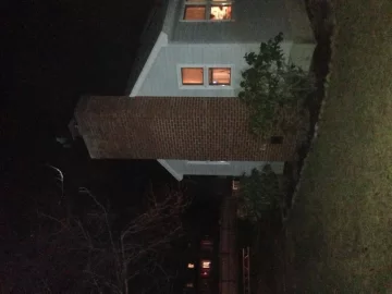

Alright, I had money in hand and went to finally make my purchase, a hearthstone clydesdale. I was happy with price of unit, so we started talking about install. From reading these forums I was able to ask the right questions, I think. Something told me to hold off a day or two and post here. Here is the deal, I have a 14ft exterior chimney the specs call for a min 13ft. I inquired if that would be a problem being so close to min height. He said no. I asked if they as part of there installation install insulated liner, figuring that would help draft with short chimney, he said "maybe", but if I wanted insulated liner that the cost of it would triple. I also noticed in the clydesdale manual that the install calls for a seal off plate, which I assume is a block off plate. I inquired if they do that as part of the install, he said no that they just stuff roxal up there. This is a big purchase for me, and it seems like when I asked question about possible performance issues he just kept saying maybe, you never know. What do you guys and galls think about the chimney, do you think I'll have draft issues?

No way it should triple for an insulated liner, the insulation isnt that much and doesnt take long to put it on the liner. Since its an exterior chimney I would definately insulate.
You could make your own block off plate, instructions are on this site and it would cost you $10 and your time, if I can do it, anyone can.
You could save money by the doing the install yourself with the help of a friend, its not that hard, the only hard part is if you have to cut the damper out and sometimes some bricks to make room for the liner.

Sorry that was hurting my eyes ;).

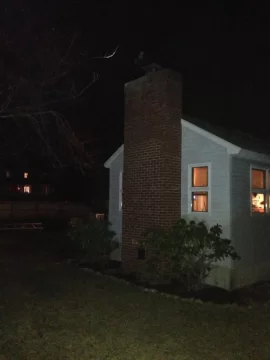

I think it will draft fine I don't see many obstacles however a daylight picture would be better. My thoughts on draft are you wont know for sure till it is installed ! Everything takes tweaking when first installed and every stove burns/drafts different. Once it is in if there are issues they can be addressed by adding to the height or using draft caps and the like. I would not over think this issue because it really will be worth the effort when it is finished. I would most definitely get a stainless liner installed if you install it without one you have a slammer and they are not safe. As for block off plate you will want one but it can be scrap steel from a metal shop or something like that to save money. It will stop heat from going out the brick and throw it back into the room.

Sorry one more thing, the salesman told me that the liner is 399 and comes in a 25" lengths, they buys the kits in bulk. So even though my chimney is only 14ft I still have to pay for all 25ft. Like I already said, he said the cost would triple for insulated. $1200 for insulated liner!!! Why won't they just charge me for what I need.
LOOK ALL OVER this is really the best thing to do if you have not. Shop the field and you wont be sorry you did you can take estimates to other dealers and work deals for cheaper cost installs.
Pete
If he has a reasonable price on the stove, buy it from him. Buy the liner kit on-line for a fraction of what he is charging. Your roof is not too steep, the DIY install should be pretty simple. How wide is the opening through your damper? Do you have a sawzall with a "torch" blade to make the opening larger if necessary? This is usually the toughest part of the job.
Block-off plate is easy, just follow the instructions on this site.
Get everything in the house, look it all over, read the install guide, then ask a bunch of questions. The members here have done it thousands of times and, as you ask questions and post some pictures, will guide you to the quickest and safest way to get the install done.

I think your chimney is too short as the measure is from the exhaust of your stove to the top of the chimney (unless your stove will be in the cellar).. Makes no sense to triple the liner price to have it insulated which I feel you should as it is outside and will improve your draft and help to reduce creosote with the higher flue temps.. +1 on the block-off plate and other comments..

The measurement was from the hearth to the top of chimney, roughly. Not from the ground to the top.

I've got a similar height situation (±15') and masonry chimney. My stove is installed in front of existing fireplace, ±7x13" clay flue liner.
I was able to install rigid 6" dia. liner inside my flue, and a couple rotated 90 deg. fittings to get through the damper (no cutting was required).
Draft is fine, except on damp 40-50 F days, when I need to leave the air intake more open. I didn't insulate the liner because of lack of space (did not want to remove the clay flue tiles). Bottom is stuffed with insulation around pipe.
I'd probably get better draft on those marginal days with an insulated liner...but it's not the end of the world as is.
As to the salesperson.... I'd be most worried about the type of guy who absolutely guarantees everything will be perfect without even looking at an install location. Or the type of installer that isn't familiar with the manufacturer's recommendations and installation requirements. Find a shop that's service oriented, knows the product and is willing to follow up/trouble shoot.

You should use an insulated liner. If you have any doubt about draft, installing insulation will help draft tremendously. Look online, I know you can find a liner kit and insulation for a good deal, around $450 for the liner and insulation, and it is a job doable for the average DIY-er.

Given your short outside chimney, I think that insulating the liner and installing a block off plate are important.
