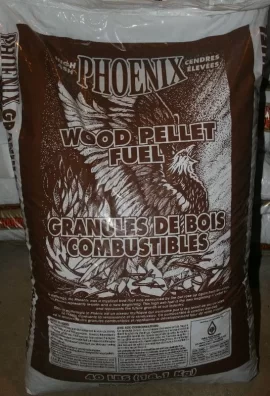

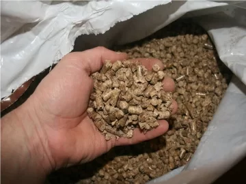

I had some extra time today after work , So I took a ride to get my switchgrass pellets. Tomorrow I will clean my stove and start to burn them. If people are interested I will post my findings with these pellets. I have a IR temp gun so I can check the output temps of the heat exchanger. Might bring home my meter that I can check the exhaust temps too!
I have a few pictures to post as well.
They look like wood pellets and of coarse are the same size. The color is a little different than I'm used to, Kind of dark. And have a sweet smell to them.
Here's the pictures.
Let me know what you need for info on these and I will post it for you.

If these are switchgrass pellets, why does the front of the bag say "wood pellet" and the back of the bag say that the material these are made of is "wood"?
I have the same question, why is "Wood" stated on the bag. I searched the net for "Pheonix Wood Pellets" and could not find anything on them. The only mention of them was on a page listing manufacturers:
Energex American Inc. RR5 Box 343, Mifflintown, PA 17059 (866) 373-5538 www.energex.com
Brand names: Energex American/Juniata pellets, Phoenix high ash, low cost wood pellets
This leads me to believe that they are made by Energex even though I could not find anything on the Energex site. Does the bag list a website to visit for more information?
The bag doesn't say anything about switchgrass. Phoenix Economy wood pellets and a mention of containing bark. The only other person that I see a post about trying them was drcoolbreeze. He gone now.

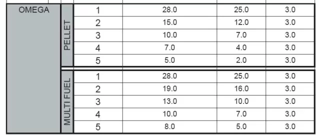

multi fuel mode changes the feed times on lower and or higher in differnt setting than pellet mode
Note sure how much it will help it just helps burn slower because some Future fuel burns slowers and need lower feed rate times
see chart
  • [Hearth.com] I went to get my switchgrass pellets today
Rod,
I was burning them on 3 pellet. I did it to compare the heat output(1:1) with the other wood pellets I compared. When I get thru burning the furnace grade Oak pellets(which are burning nicely I must add). I'm going to burn some corn in multifuel mode. I picked 5 50LB. bags this morning. Then I'll throw them back in an see if they burn cleaner in the multi fuel mode.
Thanks for the feed chart. I thought it would feed less fuel in multi mode. Well actually it feeds the same amount. Just has more off time. So less fuel per cycle. That explains it.
