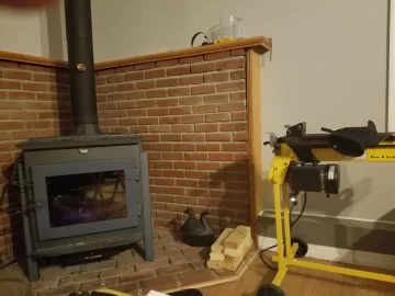

I wasn't married due to me having an electric splitter in my den near the hearth.
That's a great photo...I definitely have an understanding wife, but a wood splitter in the family room isn't going to happen in my house.
