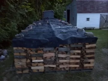

I see folks with a good amount of land being able to stack a lot of wood, but are there any tips/pics/videos/examples of folks cramming in a lot of wood in a small amount of space?

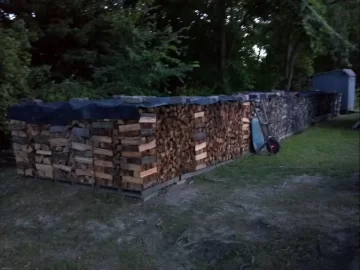

Already, I would no longer stack some of my first stacks individually, but I would lean two stacks into each other. The other thought is to use some very tall garden stakes (the big green, metal ones) at the ends of my stacks. This would allow me to stack "regular" right up until the very end and not have to criss cross the ends.
And of course I could stack higher, but it looks like in order to do this in a stable way I'd have to put perhaps 3 or 4 rows tightly together for the additional stability as I stack higher.
My wife is sensitive of looking too "country" in the neighborhood, so I hope to keep it relatively clean and neat. (Heck she wants me to install a fence in front of my stacks, but that would increase the payoff time for switching to wood heat)
Thoughts?
Here is my current setup:
http://youtu.be/Mckx8d5uaOA
Ideally all the stacks should be in a single row in full sun aligned with the prevailing wind. In reality you work with what you got. The idea of using steel posts or even saplings on either end with a rope through the stack to hold them upright is good. I have also used small straight branches laid between adjacent rows that have a 8" gap between them to tie the stack rows together so they don't fall over sideways, Just stack in long pole with the firewood every few courses. One thing to consider is to get rid of the plastic on the tops of rows, unless you can install the plastic so that water runs off to the sides or ends, it usually slows drying rather then speeds it up. I would suggest checking out home centers or the local recycling center to see if you can get some bent or odd spec metal roofing to lay on top of the stacks, it gives good air circulation and sheds water well. If you do decide to stack high make darn sure that you don't have little folks around that might climb the stacks and get hurt.

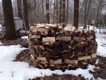

IMO the best way to manage wood inventory is to have the best wood possible. Best equals, highest output and fastest seasoning. These species are Ash, Locust, Beech, Hard Maples. Stay away from Oak. it requires 2-3 yrs of seasoning. I have 2+acres and don't have room for wood to season for 3 yrs. The only way I take oak is if someone drops it in my yard for me. That sometimes happens.
I don't believe in Holzhaufens, but they do look nice.

The idea of putting a straight stick in between rows and then stringing piles to keep the upright is a nice idea. The clear plastic was my way to minimize how much the stacks stick out to the neighborhood (and to the wife). But perhaps next time I will cut the strips wider so it ensues the rain runs off.

Not sure belief systems enter into it, but have you ever tried one? My stuff dries quickly and they do look good. Good luck

In my opinion what looks crappy with wood piles is plastic tarps and random shaped roofing. (which is what I have, lol.) Neatly stacked even topped stacks are way more appealing visually. The cross hatching cribbing is a pain in the A$$ but looks really sharp. Privacy fencing blocks airflow to the area. Dont waste your time or money on that.

Easiest thing work wise would be to spray back the weeds and trim tree limbs and even up the height of your piles so they are all level. Then if you do cover them it will be easier. Use the wood from the piles that fell over to crib the ends of the stacks.
The ground stays damp in shaded areas of your lawn. Use pallets or rot resistant woods at the bottom of your stacks. Locust cedar sassafras oak.
I would agree the plastic on top doesn't look great, but I could straighten it out some. Do they make dull gray colored tarps? :p (that won't disintegrate like the typical blue plastic tarp after a year)
I bought bricks from HD and put my stacks up on them with the aide of 2 x 4s I had leftover. I also use part of a fence I had replaced to stack stuff on top. Evening off is a fine idea, and using the wood the wood that fell over to crib is cool too, but I'm lazy, if I can find garden stakes, game on. :p

Tarps are expensive and none of them last. Scrap metal roofing (but now you are getting woodchucky again). My sister bought tarps off of Amazon last year and they are all sun rotted.
I agree with Backwood Savage that wood self retained by cribbing is the cheapest and most esthetically appealling way to stack piles. Zero money investment. zero garbage.
hmm! that's how I do it right on the front lawn. got two now about 9 cords. one 8 foot diameter and another 12foot diameter.
got another 8-9 cord lined along driveway with cribbed ends doesn't take any longer to stack cribs if you throw the good crib pieces to the ends as your stacking.

Is anyone aware of any studies involving the Holzhaufen vs traditional stacking?
Lots of discussion on it regarding drying time. But you can't beat the space requirement! you can stack as high as you want just increase the dia. Stacks fast as long as you have access to the whole circumference.
