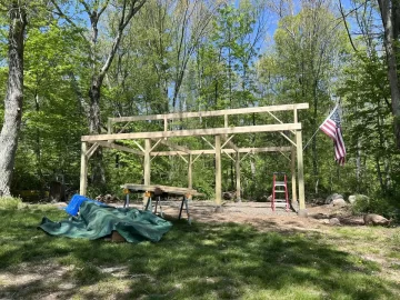

I'm in the process of finishing up my woodshed (see nearby image). I am undecided on sheathing it, I may cover up just the back, both ends and the back, or actually now i'm leaning toward leaving all sides open - but in all cases the entire front is wide open. Anyways, the building faces south. I plan to fill one bay (the farthest left) as much as possible with wood. I'm wondering how people would recommend stacking it, especially with regard to the sun and air flow. Each bay is 8 foot wide, 16 foot deep, and about 7.5 foot tall. So would you run your stacks front to back or left to right? Front to back I think I'd get about 4 runs, so that means less end caps to stack criss/cross. Left to right your first row gets full sun all day, but the back rows are shaded. I guess question is - is it better to let a bit of sun shine down in between all the rows? or let just your front row get baked in the sun all day.

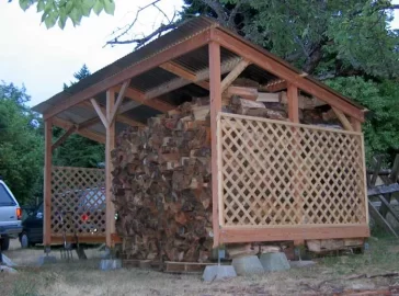

The sides, back and middle partition all act as supports in our shed. The splits can be fit tight right up to them. I used lattice panels to maximize air circulation through the stacks. Good air circulation makes a nice difference in drying speed.

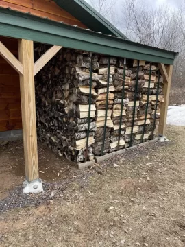

I do it like this. Try to keep an inch or two between the stacks for better air flow.

This is what I settled on. For now I’m gonna leave all the sides of the building open, like a pavilion/gazebo. There’s a good overhang on the roof on all sides, and this way snow and leaves won’t blow in and drift up. Plus firewood will have airflow from all directions. I wanted removable/temporary wood stacking supports in case I ever want to open it up or repurpose it. So these are just 1” x 4” oak strips I already had, with the bottoms in a cinder block. I know I shouldn’t stack directly on the ground, but it’s a 4” thick crushed stone base and it’s very dry in that area, I think it’ll be fine. By my math each row like this holds half a cord and I can fit up to 9 rows.
