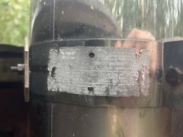

Also when I climbed up there, I noticed a sticker that I didn’t realize was legible still is somewhat deciferable.
It has a “Warnock Hersey” logo but that’s not the manufacturer. It does appear to faintly read “Exce” by model and if so is this ICC Excel?
It looks pretty close, but wanted to consult the seasoned minds here.
Also don’t ask me why the chimney cap is snipped on the one side… Previous owner.
[Hearth.com] Identify the manufacturer of this double wall chimney pipe [Hearth.com] Identify the manufacturer of this double wall chimney pipe [Hearth.com] Identify the manufacturer of this double wall chimney pipe [Hearth.com] Identify the manufacturer of this double wall chimney pipe [Hearth.com] Identify the manufacturer of this double wall chimney pipe
Yes, that looks like ICC Excel.
