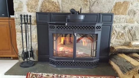

Hello everyone, I'm a newbie on this forum.
It seems that many are disappointed with their Merrimack inserts for burning too much wood or unable to sustain a burn overnight. We're on our 4th year with a Merrimack, we were initially disappointed for the same reasons but have fixed it.
The Merrimack introduces fresh air through the secondary air tubes at the top of the box which you cannot control. I disabled those secondary air tubes, now we can turn the air control all the way close and have beautiful licking flames that last for hours. We load it up half-full before bedtime, 8 hours later there still are flames. A few times I could re-establish a fire after 20 hours using kindling on the hot coals that remained. We now use 1/4 the firewood compared to the first 2 years for similar burn times.
This change likely affects the emissions if I assume that is the purpose of the secondary air.
Countering that, burning 1/4 the amount of wood for the same heat gain has probably less emissions than burning 4x more at lower emissions level. Factor in is the emissions from effort to collect, split, move and stack 4x more fallen trees, almost all of it involving using gas motors in my case (chainsaw, diesel tractor, splitter, truck etc.). We process our own firewood but if we purchased it from elsewhere, then we'd have to include the emissions of hauling the load also. Lastly, factor in heating with oil when the cleaner-burning Merrimack runs out of heat after it wasted its wood up the chimney, then I'm pretty certain that overall it's better for the environment also. It certainly is a lot better for me and my budget.
With that said, a few questions. Is that ethically OK to disable the secondary air tubes? If so, should I post the fairly simple process to do the fix?

Thanks for your input but perhaps you don't know the specifics of the Merrimack concerns: owners say that it is burning through a full firebox in a few hours, disappointed about the heat gain from fuel concerned. Having used VC fireplaces for over 10 years I know what to expect, and when I burned through my entire 11 cord stash in the first year with the new Merrimack, I knew it had a problem.
I run it just a hot as before, harvesting at the same rate as before because firebox temperature is the same with or without the afterburners. I never smolder a fire.

Thanks for all your replies.
@jetsam - you hit it on the head: in my opinion the Merrimack is in your first category - an EPA emissions solution slammed on as an afterthought. Disappointingly so from VC, ruining an otherwise fine and beautiful insert.
@moresnow - exactly the same problem as you describe, my "fix" for the Merrimack is the same as yours by closing up the secondary air.
@ED 3000 - glass stays clean, sometimes a bit of white ash coating in the morning but that burns off with when the new batch of wood gets going. In the cold spell recently with temps around 15-F daytime, we turned off the geothermal heat pumps (they don't work well in that cold) and relied purely on the Merrimack in the living room and a Winterwarm in the basement to heat a drafty 3400 sq ft old stone house for 5 days straight. The glass was a bit glossed over after a week but cleaner than the Winterwarm which gets sooty in a day no matter what.
@EatenByLimestone - can't say at this time, we have it cleaned out every 2 years and have not done so since the fix of 2015 (due now). I don't expect a difference because it runs just as hot as before. I can't measure flue temp easily, not accessible.
@webby3650 and in general on this thread:
The primary air opening size is 2 square inches, damping it down closes this almost entirely, perhaps 1/2 sq inch open. The two secondary air openings on the other hand are about 3 square inches each with no ability to choke it down. (I'm going from memory about sizes when I had the thing apart, but the ratio is what matters, secondary about 3 times primary. And no control.)
Before the fix, it made NO difference when you close off the primary all the way. If it made a difference it was so small that you could not tell watching it for minutes before and after. Two cubic feet of fuel would be gone in 4 hours. I believed and proved that was on account of the secondary intakes that remained fully open.
After blanking off the secondary intakes, now when we close the primary it does exactly what you expect - within seconds the flames settle with a steady swirl like any other good firebox. Open it up and within seconds the fire responds.
So we are burning 1/4 the firewood simply because it is not wasting it up the chimney in uncontrollable flames. In my opinion, overall emissions is lower as I tried to explain at the onset.
Just measured the steady but small fires now which has been going since this morning, the Merrimack at 550-F, the Winterwarm at 600. They will idle along like this all day long with two small feeds each, then a large load at bedtime. Huge difference since castration.
