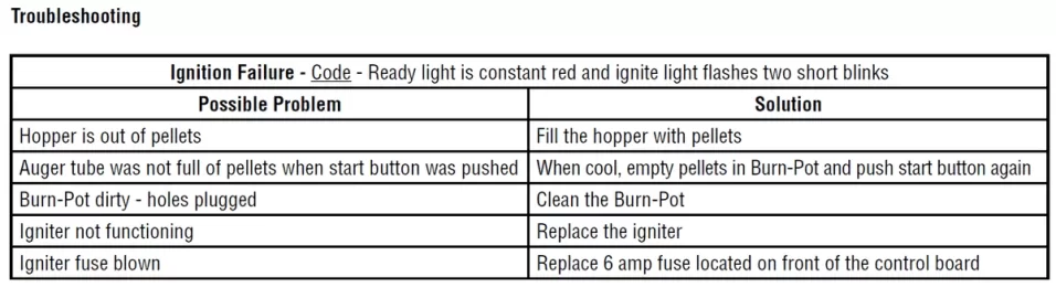

Hello
Here is the Winslow PS40 trobleshooting for your error. If not one of these, it could be a bad control panel.
[Hearth.com] Ignition Failure
Thanks Don2222. I have the same list of solutions (all of which I have tried) in my manual. My next step is to replace all the gaskets and vacuum out the combustion blower. I hope its not the control panel. They're over $300 to replace.
