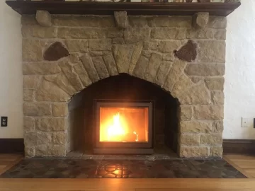

Finally installed

Fill us in on operation/performance details after you have run a few loads through it. It certainly has a nice fire view.

Very nice! I like that you were able to save the stone archwork.
How will you be using the stove? 24/7 heating or mostly nights and weekend burning?
I don't really have a reference point since this is my first functional fireplace as an adult. Its been easy to start - much easier than the open fireplace we had growing up. As others have stated, its single burn rate and won't be able to keep a fire going over night but thats not something I need. Its for night and weekends...but given the pandemic I might use it while working from home as well.
With one log the heat is pretty gentle, 3-4 is where is starts to kick off a good amount of heat. Its in a large room with a lot of brick work so I wonder if those absorb some of the heat.
I can definitely see the advantage of going with something with more control but I had a set of parameters I was working within. The most efficient option would have been to omit using the fireplace.
I'm very happy with the look of the fireplace as you can see more of it than you could before with the screen in place. Its more 3 dimentional now. The screen is likely to live its life in the basement....might make appearances during the summer.
Anyway, my wife saw this as a quixotic adventure and at some points it was but now that its here I think she enjoys it as much as I do. Its definitely something that makes the home feel distinctly ours. I'm well aware that I'm recreating a childhood memory and its damn comforting after a crazy and difficult year.
Oh, one question - The space directly above the stove isn't sealed off - the space where the flue used to be. I'm curious if that would be worth pursuing to make the whole system more efficient. The installers didn't say anything about it so perhaps its fine.
