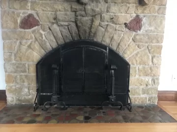

I'm interested in buying a Stuv 16 - anything comparable I should look at?
rasputin
Dec 3, 2019
21
Madison, WI
I'd like to find a more contemporary insert or wood stove to install inside my 1927 fireplace. I found the Stuv-16 https://stuvamerica.com/en/fireplaces/the-stuv-16-in https://stuvamerica.com/en/stoves/stuv-16-cube-h - I like the looks but I'm curious if there's anything else I should consider. It seems that there are a number of similar models out there...only available in Europe. I've checked local fireplace insert sellers and nobody has been helpful which has been odd / annoying. One woman went so far as to call herself the dream killer. (Thanks!)
Note - previous thread - https://www.hearth.com/talk/threads/seeking-wood-burning-insert-recommendations.178551/
Included a pic of the fireplace. Dimensions are 48" wide, 20" deep, and the arch ranges from 24" to 36" tall.
Much appreciated.

They do look fantastic. But to me as a single burn rate unit it isn't a functional heater
Reactions: EbS-P
Can you be more specific?
I'm interest in burning wood for ambiance. If I wanted efficiency I'd seal the fireplace and let the furnace continue to do its job.
It is basically a freestanding fireplace. You will have no control over the fire. To me if I am spending the money on a stove and liner I want it to be an efficient heater as well as look good. But that is just my opinion doesn't mean yours is wrong
Reactions: Mech e
I completely agree and part of the reason why I'm posting here is because I'm frustrated by lack of options for my given parameters. If I want something with a traditional look there are a ton of options. If I'm willing to put a large piece of steel over the front of the hearth there are plenty of options.
Regarding efficiency - I assume you're exaggerating, otherwise it makes zero sense to consider purchasing such a stove / insert.
Exaggerating how? We don't know the efficiency or btu output of this unit because it isn't tested. As a fbr appliance they don't have to test in the same way as regular stoves
You're basically saying it does nothing when used as an insert.
I am sure it will be better than an open fireplace. But honestly we have no clue how much better
So you're saying the numbers they provide aren't trustworthy? Whats an fbr appliance?
Fixed burn rate. Meaning you have no air control. You just put wood in it and let it burn. We have no idea how they arrived at those numbers. All stoves sold here now that are not fbr appliances need to test using the same methods. These do not
Might be much worse than an open fireplace for your heating bill. Insert means no flue damper. Fixed burn rate means no air control. Together, that means the unit's normal air intake whooshing up your flue 24/7 even if you never use it.
The open fireplace may have a higher volume flue, but you can shut the flue when you're not using it.
If the whole deal is just for cosmetics, that might be fine, but don't confuse it with a heater that adds BTUs to the envelope.

I seriously doubt it would be worse than an open fireplace. Most fireplace dampers leak more than the intake for that stove will. But it is possible.

Just to clarify, is the idea to put a freestanding Stuv 16 Cube in the fireplace? Looks like it will fit and it's a relatively efficient and clean burner. One concern is that there is no blower option. With the stove in the deep fireplace a lot of the heat will go to the masonry. Be sure a block-off plate is put in place below the damper area to keep as much as possible in the room.
The manual goes into repeated detail about strongly recommending an outside air supply. Does the fireplace have one? If not, the base plate covers need to be removed for room air supply.
Another stove that might work here is the high efficiency MF Fire Nova.
rasputin , take a look at the Osburn Inspire 2000. That has a clean contemporary look and a blower. It could have a custom surround made to fit inside the arch.
