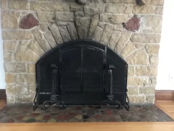

I'd like to get a nice wood burning insert for my large and old fireplace. I like what I see on this site - https://www.acucraft.com/products/ - but curious about what other options exist, particularly closer to home. (Madison, WI)
Its important to me to fit the style of the home, hence the reason why I've overlooked off the shelf options.
I've included a pic of my fireplace below. The firebox is about 4 feet wide.

The Accucraft site is showing complete fireplaces. To install one would mean replacing what is there completely. I don't think that is what you want to do. An insert with a custom surround is one option if the goal is to keep the current arch. Another might be to put in a freestanding stove if there is room.
What is the height of the fireplace in the center? Height at the opening at the beginning of the arch? How deep is the fireplace?

the firebox is 48" wide, 20" deep, and the arch ranges from 24" to 36" tall.
Definitely not interested in a freestanding stove. Nor am I interested in a smaller insert with a custom surround, at least if its going to look like what it sounds like.
Yes, its possible that what I'm hoping to find would require a considerable rebuild of the chimney / fireplace although I'm hoping not.
Sounds like you are looking more for form over function. Completely the opposite of how I think. Are you an architect by chance? ==c ;lol :p
So I was browsing inserts yesterday and liked how the arched door Lopi inserts look. If you can get one to fit in the opening then you just need to have a custom surround cut out of steel and painted that fits the insert and your existing stone arch. Take a look at these to see if you like the design.

That is a large area for a surround to cover and it would be a shame to lose the arch.
If the area where the fireplace is open to the rest of the house, then go with a large, 3 cu ft insert and full 6"r insulated liner. With that beautiful arch I would also consider a custom, inset surround. This surround would be slightly recessed and fit within the arch, preserving the look. Or an insert could be installed with no surround. That is not a terrible look with the right insert.
I believe its an outside flue. My house was built in 1927.
It would be good to install the insert with a block off plate to help it to better warm the house instead of the mass of masonry above it.
