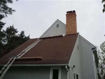

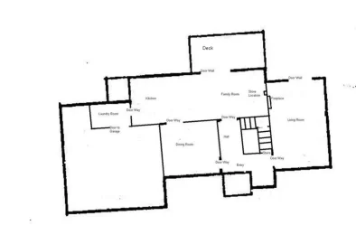

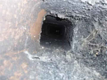

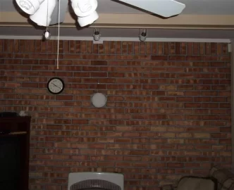

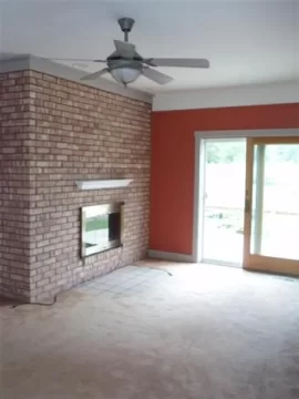

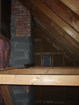

The house is a 2000 sq' two story home, I have attached a rough sketch of the lower level, the upper level covers every part of the lower level except over the living room. The house has a natural fireplace in the living room and a chimney for a wood stove in the family room. The house had a wood stove at some point, when we bought the house we put a foam plug in the hole that the wood stove used and it had newspapers from 1984 in it plugging the hole, the house was built in 1980 so I figure the wood stove was used for 4 years or so. The chimney is tall but isn't all outdoors since it shares a wall with the living room and then runs though the attic before exiting the roof. The draft on the chimney in the family room appears to be good, I pulled the foam plug to take pictures of it and I could feel the hot air leaving the house.
I have looked at some stoves and I'm leaning towards a Lopi Republic 1750 or Endeavor(like the bypass on the Endeavor). Any other stoves I should look at?
The floor plan isn't really open,(besides for family room to kitchen) how do you think the heat will travel through the house? I have a fear of overheating the kitchen/family room.

Hi, rdust and welcome to the site! It won't take you very long on this site to decide what stoves are top dog and what stoves have problems. I think even if the heat doesn't travel as well as you would like it will still cut your propane consumption in half at least. I think the attic fan or whole house fan will only blow all your warm air outside of the living space. The circulating fan as well as ceiling fans do very well at moving the air. Keep in mind that right now you are worried about overheating, after you get the stove you will only worry about the furnace kicking on ! :coolsmile:

I have a friend that has a house plan very similar to yours. He has approximately 1800+ sq ft and as long as he uses the blower on the stove it circulates the heat throughout the house without a problem.
The stove is rated to heat 400 sq ft larger than his house
His Average temps are 72° to 75° on the main floor with 66° to 68° on the second floor.
I would certainly get a stove that is rated well above the square footage of your home especially with your floor plan and the harsh winters we have been having here in Michigan.
