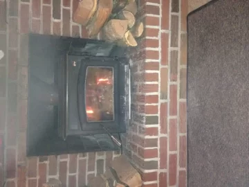

ok guys i will be installing my stove the right way tonight. vogelzang defender, got the stainless steel liner about an hour ago. Its going into a fireplace. Now where to put it... inside the fireplace or pulled out onto the hearth some. if i do onto the hearth some i will have to run a 90 deg elbow right off the stove to take it back into the opening and then another 90 to take it up into the chimney followed by the ss liner. do it this way or have that stove sitting in fireplace pulled out as far as i can with that stainless steel liner attaching. looking for the most heat out of it.

All hooked up just started the fire. Will finish up Tom with the new sheet metal an the roxul. We ll see how she does tonight
