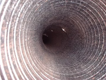

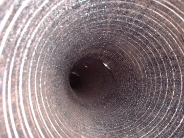

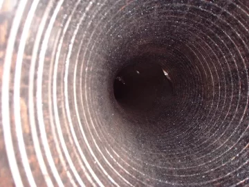

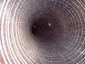

We install about 80 liners a year and have yet to have one rip at the seams once installed. You either got a very poor quality liner or got the wrong type. Could you possibly post a pic of the liner and what you are referring to as ripping apart at the seams?

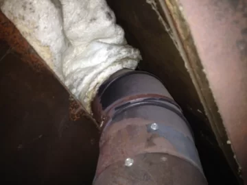

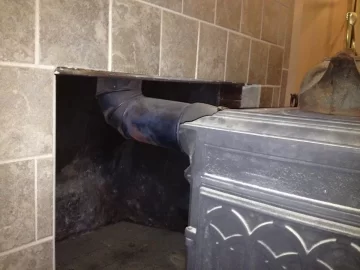

This is my current install. Was this ok the way I did the bends around the flue ?
The insulation I used was direct contact Rockwool.

These pics are from 3 yrs ago. it looks much worse now. Everytime I clean it the seams peel open more. The one all the way down is getting even bigger.

btw, the seams that peeled up that I could reach with my hand, I could push back with one finger.

that is what i thought. That is the 2 ply smooth wall liner. It is the least durable liner available. We have installed 3 of them and have pulled and replaced all of them at our cost. The most durable solution for you would be a heavy wall flexible liner. And don't transition to black pipe until you get into the firebox. Even then I would recommend stainless painted black if it is visible.

ok, so I bought junk (I figured as much)and when I do it again the bends going around the flue need to be stainless.
But other than that the way I went around the flue is ok ? I really don't wanna cut the flue with a sawzall...

Well I would bring the flex liner down into the firebox to a tee and then into the stove And yes if need be I would cut the damper frame. I almost always make sure it can be reassembled if someone wants to go back to a fireplace. But honestly in 38 years of business we have only put 3 back to an open fireplace after an insert. And yes you bought junk. any other type of liner will be more durable than that but what we use is heavy wall flexible liner. We use olympia armor flex but there are many other good manufacturers out there.
