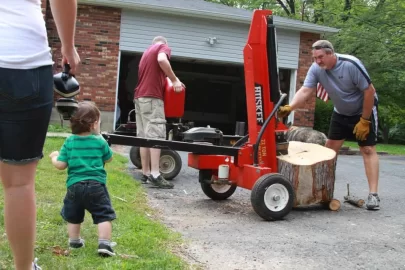

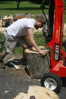

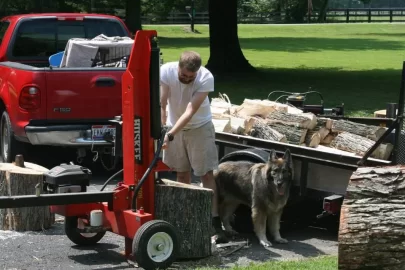

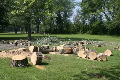

That's why I'm looking for recommendations, pictures below give you and idea of the size trees I am dealing with. My dad had to help me move some of the pieces.
