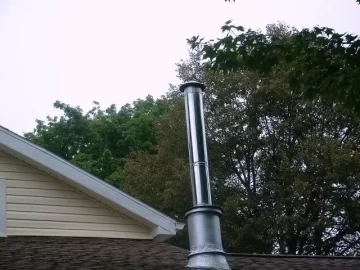

Hello Tim that is about what I did with mine. Only difference my 8" was triple pipe. I used 6" class A chimney pipe and it was just alittle to big to fit inside the 8" so pulled the 8" out and have the 6" inside a 10 pipe filled the space with vermiculite. It works fine and just enlarged the 8" top cap so the 6" would just fit thru it. Then sealed it with silicone. Here is a picture of it but I have since added 3 more feet and support braces. Also went with a new cap made for the chimney pipe.It has worked just fine.
