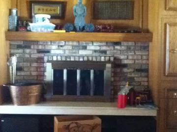

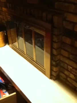

I will try to post some pictures (if I am able to figure it out) of my existing fireplace and a link to my house on google maps (so you can see the chimney)
Link to Chimney
http://maps.google.ca/maps?q=39+Can...=m&z=17&vpsrc=0&panoid=PyGL76dsKWd18Nc_iUgg1g
Pics of the fireplace to be converted (from my iPod) so the quality is not very good.

Maybe I'm missing something, which is quite possible, but the installers/dealers you've been speaking with seem like a bunch of clowns. My frustration level would be quite high at this point if I were dealing with these people.
Good luck to you and I hope your stove buying adventure ends well for you.

Well, it will be better than the masory fireplace that I have now in terms of heat, so I am happy about that. Am I getting the most for my money, no, but it appears here in Calgary, they don't belive in insulation on the liner.
I stumbled across this line, which might help explain why these guys don't insulate:
"Note that the rules for liners are slightly different in Canada, with the result that insulation around liners is not used as often as in the US."
http://woodheat.org/liner-advice.html
Exactly why that might be, I cannot say. But you might as well relax and let your WETT guy do it his way. Enjoy!
