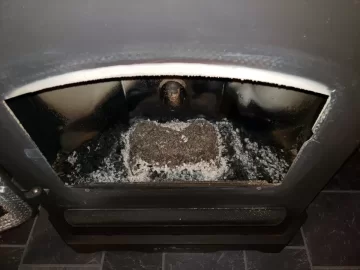

Menards recently switched pellets to Indeck. These are the worst pellets Ive run yet. I have a Pelpro pp130. The Indeck pellets left a hard, flaky soot in my stove and a lot of unburned pellets. The Dejnos from Kenosha, WI have been top notch. Dejnos leave very little soot but still leave a good amount on the glass. The rest of the chamber is pretty clean. Attached is a pic of what was left over after running Indeck.

I can't even distinguish where your burn pot starts and ends in that pic its so full of ash, if you can't see the edges of the burn pot its past time to clean it as the fire will get to close to the pellet chute, and unburnt pellets anywhere but in the burn pot is bad, you don't want unburnt pellets waiting to ignite outside of the burn pot.

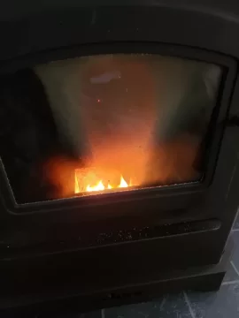

The fire was way too close to the shoot and I think it softened the pellets. The auger clogged twice. First time ever for me and all because of these pellets. Im on day 2 of being back with Dejnos and issue free. Dejnos is really a great product. Anyone in northern IL or southern WI should consider them. The Dejnos produce a good amount of soot on the window but the rest of the chamber is extremely clean.

Good lord what a disaster and a prime cause of backburn and stove issues. You need to do a comprehensive cleaning of the unit and probably the pellet venting as well.
That burn chamber is a disgrace.:rolleyes:

I clean the burn chamber every third day before work. This happened over night. I cleaned the stove, swapped to Indeck and this happened. Not lack of maintenance.
I suggest you clean every 2 days then. You need to check and clean your external venting and cleanout as well. Keep in mind that, the more ash buildup inside the stove, the less efficient it becomes because ash is a great insulator and impeded heat transfer.

So far they're doing ok. Not burning as hot as I'd like, but thankfully it's not terribly cold out. The ash doesn't appear to be excessive either.
