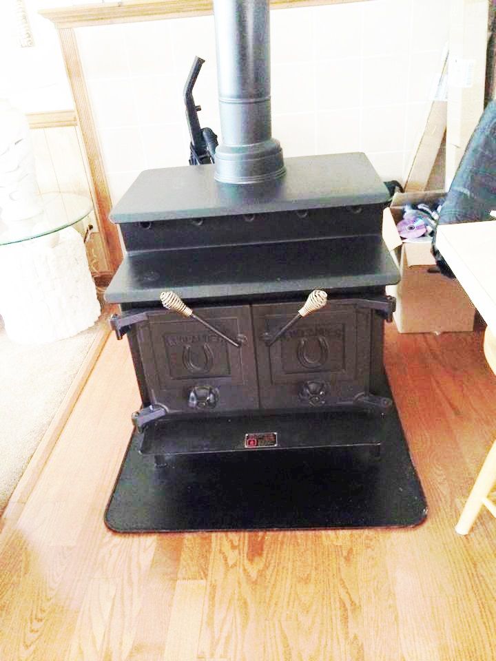

We just picked up an Englander Stove to replace the Vogelzang Heartwood Heater Circulator that came with the house we bought last spring. We are not happy with the Vogelzang so were looking for an older stove and found this Englander. It's in new condition-never used. Complete with optional glass door inserts and original instructions. Think we got a good deal on it so we jumped on it.
But can't find out much about them--any information, things to watch out for, installation tips, estimate on BTUs?? What's a good price for it? Hoping we got a good deal.
Guy told us it came with his house which was bought in the 80's and they never used it. Size is similiar to a Fisher Pappa Bear so thinking maybe the BTUs are similar? Thanks!

Contact Mike Holton via a conversation here - @stoveguy2esw . Maybe Englander will want to buy the stove as a museum piece? You might also ask him if it is ok to reduce the flue pipe size on this stove. I suspect not.
why reduce the flue pipe size?
Most stoves are made to be used with a specific flue size. It appears that the stove in the pic has had it's flue size reduced. Very nice stove btw. For me, 3 to 4 hundred would be a good price for that stove. Any more than that and I'd go for a new one.
model 28-I definately from the mid 80's as its on legs it appears. stove would compare to a Papa Bear in heat output though i do not have a "rating" on it as it predates Phase by quite a ways.
one thing i see that isnt making me happy in the picture is the floor protector does not look to be large enough should be 48X48
as for flue reduction , its usually not a good idea to do so, as it can restrict flow in some cases, dropping for an 8 inch to a 6 inch is signifigant as you go from a cross sectional value of 50.4 sq inches to 28.26 sq inches which is almost reducing by half, one would need an extremely powerful flue system to make up for that much of a loss in flue opening

the floor mat protection is his not ours, so not worried about that. We will be putting it in our basement to replace the current stove we have.
The only thing I'm confused on is this flue reduction. We didn't know about different flue sizes and don't want problems. We do not wish to reduce flue size or cause issues so are you saying it looks like the flue has been reduced on this stove? how do we determine our current flue size--by measuring the pipe at the chimney access?

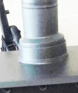

This where the reduction is occurring. It looks like an 8" to 6" reducer is inserted in the flue collar.
