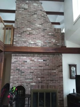

Here is a picture, should I not install a block off plate and allow the heat up the chimney to the cap?

Looks like a very large, full masonry chimney? What is the depth at the top of the fireplace?
For an insert, the PE Summit would fit there. If the flue is large enough to accommodate an 8" liner then the Kuma Sequoia or Buck 91 insert would work.

No matter what stove you choose put a block off plate. I had an insert and had a block off plate then I went to a rear vent free stander and had to make another. The heat I get now is better than from the insert.
I have similar fireplace dimensions as you. See if you like any of the Osburn inserts, they're more of a straight, clean line design as opposed to the intricate designs of Enviro or VC. They also have large face plates that will cover your dimensions. There's either the 2400 or 2000 that should fit in there.

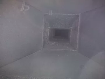

I have a full masonry chimney that extends out through the roof, the opening tapers until it reaches the flue which appears to be 10x14. I will post a picture. The fireplace opening is rectangular 40x32x32 and my floor plan is pretty open.

Is the entire structure masonry, or is it 2x with a veneer? If it's solid masonry, I'd choose a radient stove and let it heat the house. If its veneer I'd go convective.
Yes it is clearly a masonry chimney
