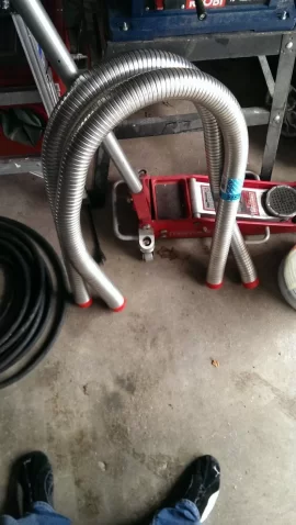

I currently have a 4" flex liner through my masonry chimney which is approximately 11 - 12 feet long. It is terminated at the top with a cap/ plate. I plan to drill a hole through the top plate and run 2" steel tubing for outside air. (I'll put a 90 or probably a little more bend at the top with a screen to keep the rain etc out). Ok, do the question: I was planning to shove some roxul down around/ between both tubes as best I could. Do you guys think it is worth it? It's going to be tough to force large pieces down.
Whitfields don't have a large diameter OAK connection. It's raining today, but tomorrow I think I'll start. The reason I'm running the outside air to the top of the chimney is because it sealed air tight with a stainless cap/ rtv. Let's see how this goes.
  • [Hearth.com] Insert chimney insulation
