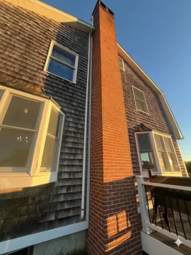

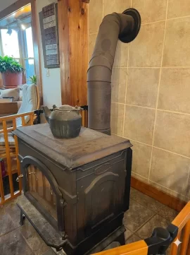

My chimney goes straight up from the top of the insert, so the fiberglass rods do not need to bend much. I’ve attached pictures of my friend’s stove and chimney.
I am assuming the process would be to detach the black pipe and clean that separately from the chimney.
When I clean the chimney, it looks like the rods will have to make a 90 degree turn. Will that be a problem? Is a different tool needed for this chimney set up?

Here is the chimney
  • [Hearth.com] Chimney cleaning

Ok, I have rods that wouldn’t do a 90 either, they are a stiffer fiberglass. I also have the white sooteater rods that would without issue.
Now a double 90 I will let someone else remark on, I only have to go through a single.

I have a similar setup.
A 90 in stove pipe and a 90 into outside lined masonry.
I take the stove pipe off and have the rods start horizontal into the thimble.
White soot eater.
Takes a bit of finagling to get them to bend up 90 deg.
Moreover you want to vacuum out any soot that you sweep in the masonry. Without a clean out you'll have to take off the stove pipe anyway to vacuum thru the thimble.

What does the thimble connect to, a metal 6" liner or clay flue tile? If your sooteater is clipped to fit a 6" pipe and there is say a 8x12 clay lined chimney, then the cleaning will not be thorough.
