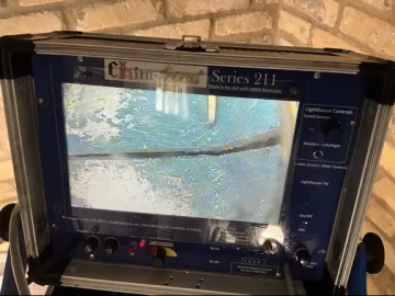

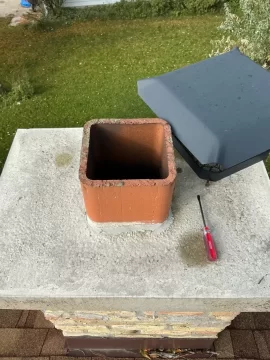

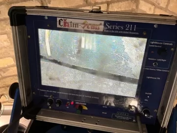

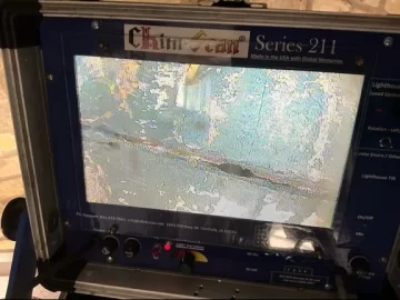

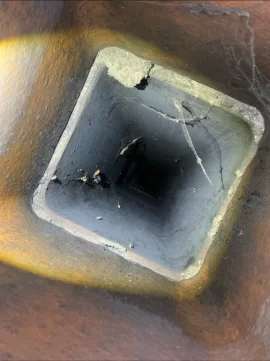

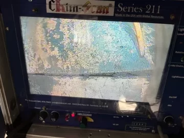

Hello,
I had a company out to clean/inspect my chimney. They found small vertical cracks in the clay flue tiles and gaps of missing mortar in the flue tile joints. They quoted me $8,000 to fix it with heat shield joint repair (one year warranty). The chimney is brick with a clay liner and exterior to the house. I burn dry wood in a modern efficient stove, so they didn't find much creosote. I'm wondering:
![[Hearth.com] Chimney Advice [Hearth.com] Chimney Advice](https://www.hearth.com/talk/data/attachments/349/349836-d09ba4877b08556b5862f59d08cb3681.jpg?hash=J9qV6ZyGdv)
![[Hearth.com] Chimney Advice [Hearth.com] Chimney Advice](https://www.hearth.com/talk/data/attachments/349/349837-e1087ac4a497829f1dea9a02dd6c962a.jpg?hash=1bS_2RbdhH)
![[Hearth.com] Chimney Advice [Hearth.com] Chimney Advice](https://www.hearth.com/talk/data/attachments/349/349838-37341fc0178174152baf6fb95b87be6c.jpg?hash=04T6lVv6XW)
![[Hearth.com] Chimney Advice [Hearth.com] Chimney Advice](https://www.hearth.com/talk/data/attachments/349/349839-3ec8b60b7721063bda98f947945f578a.jpg?hash=ifsTXw9YIk)
![[Hearth.com] Chimney Advice [Hearth.com] Chimney Advice](https://www.hearth.com/talk/data/attachments/349/349840-3ffa54a719cd18da6b6247857749afc8.jpg?hash=WiJdqJOHgJ)
![[Hearth.com] Chimney Advice [Hearth.com] Chimney Advice](https://www.hearth.com/talk/data/attachments/349/349841-a64bd37a69188b5ff6d0bad37b5b16da.jpg?hash=g4lrsxCQoe)
- How dangerous is using the stove with the chimney in it's current condition? I realize it's not ideal, but with a clean burning stove is there much chance of a creosote fire? The company, of course, told me not to.
- Is that joint repair a good idea? They said a liner would be a few thousand more.
- If joint repair is OK, is that estimate reasonable? I'm in the Midwest.
- I'm thinking about putting a liner in as a DIY project. I'm fairly handy and have a bunch of tools, but I've never done any chimney work. Is it doable, or a bad idea?
