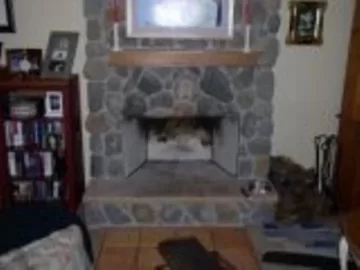

This is a photo of my existing set up. I will be installing a mantle shield. I'm concerned about the sheet rock/framing beneath the stone. Thanks for all the help, Ken

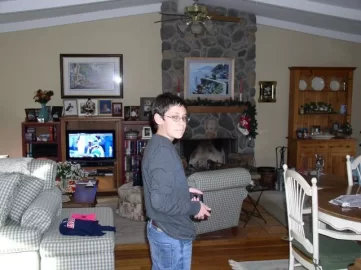

Existting room with wood stacker/gatherer

Yes, the insert manuel approves ZC install. I am concerned about the heat on the stone beneath the mantle.(under the surround) I may bend a heat shield behind the surround on top of the stone.
My reason for asking is this - if the ZC was installed according to spec, and the insert is approved for install in the ZC, then the combustibles behind the stone overlay should not come into play. When you look at clearance to combustibles (CTC), they refer to the items in front of the fireplace i.e. a protruding mantle. Items around the ZC are covered by the specs for it's install, just like combustibles around a brick fireplace are covered in the code for the fireplace install, not the manual for the stove.
