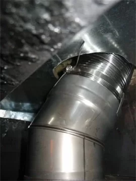

Second...The liner went down the chimney like a dream...had to use a little muscle to get it through the damper opening but it didn't need to ovalize to get through....however my connection to the stove was a little more tricky. The back of my fireplace is on an angle so the connection of the liner to the flue connector wasn't straight. Now It's all installed and the stove is pushed back to an acceptable place in the firebox (i'll have to rig up something to cover the gap between the trim kit and the brick...) but there is a very slight crimp in the liner where it connects to the flue connector on the stove....is this acceptable? I was able to look up the chimney while the stove was in place and you can see up the chimney fine and i can get my hand up there, it feels ok but im just wondering if that crimp is absolutley terrible...it seems to burn fine...and i have a great draft...any comments??
If you have to bend the liner, you're supposed to do it gradually, it will ease into a curve, or if necessary use an angled fitting. A crimp does not sound good. If you really want to know what others think about it, take a pic and be prepared for honest opinions.

I have attached a sketch to be a little more clear...As for the baffle, everything is in place as it should be. The flames actually come all the way to the front of the stove and up the flue in front of the baffle plates and cermaic blanket
I did use a straight connector that came with the kit, I inserted it into the cast piece provided by quadra-fire then inserted the liner into the stainless connector and used the hose clamp on it to tighten down real nice and tight. Let me know if the sketch helps..

I attached a sketch to the post below, thinking I'm going to just get the 15 degree elbow evening if is a slight crimp ill sleep better at night knowing its not there.
As for the glowing I don't think it was he roxul glowing but the chimney liner itself only on the back.
I think you are smart to try to remove the crimp in your flex liner, particularly if you are burning fires hot enough to make the liner glow red hot as you showed in your sketch. I'd like to hear a few more comments from other forum members as to their thoughts on the glowing liner at the point you indicated. I know I'd be getting nervous if I looked at the T-connector hooked to my flue collar and saw it glowing since it generally doesn't get above 400 - 500F when I hit it with my IR thermometer.

Yep Id rather have it done right. I'll spend the 40 bucks and 20 minutes of time to feel better about the whole thing...as for the glowing, after the first "break in" fire I had a nice roaring fire going the next day for quite a while and I didn't see it happen again, I checked it frequently too so im not sure what's going on there. Hopefully a couple more people can chime in with a few suggestions, and maybe the 15 degree elbow will alleviate the whole issue...or maybe that's just wishful thinking....
Put a fixed, not adjustible, elbow in and done. What I did with my stove sitting in the fireplace.
