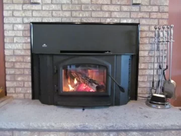

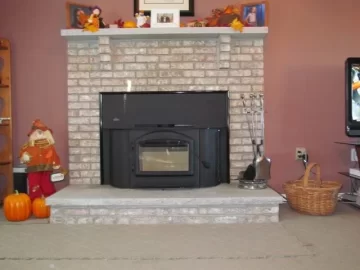

Well the insert is in. Looks good. Fired it up monday after they installed it with just a small fire and got that paint curing smell. Didnt run it tuesday but fired it again last night. No more paint smell, ran great. Put one final log on at 9:30 last night, at 6:30 this morning stove top was still 150-200 degress. Stirred the ash to find nice glowing coals and put a 2x4 on there and it fired right up. I am really impressed that it was still hot after 9 hours with only one log.
Here it is.

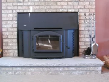

Here it is fired up this morning. Likely gonna let it burn out as I just wanted to see how long it would go overnight.

looks great , please follow up with an update when it gets cold out. good job
Very nice. That's going to make a big difference this winter.
Like they said...very nice! I actually got a warm feeling just looking at the pic :)
