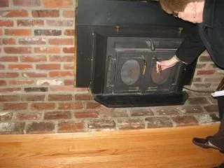

insert identification?
sjrider
Dec 16, 2005
5
my friend got this yesterday, can't find anything on what it is.
also it's opening is 3 1/2" x 14" ......whats the best way to get this to 6 or 8" round?
thanks Rich
  • [Hearth.com] insert identification?
Bingo. Craig nailed it. Silent Flame it tis.
thanks guys!!!!!
