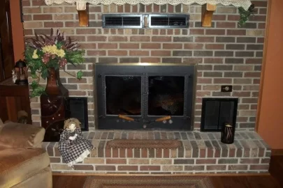

We have a all steel fireplace in a all masonry chimney that we had put in 20yrs. ago when we
built our home. It has fans on it and it has done a good job of heating our home
but in uses quite a bit of wood.
Last fall i had the chimney cleaned and was told i have some cracked liners.
with that said iam thinking that i will put a insert in with a stainless liner and reduce my wood consumption
and solve my liner problem. I will try and post a picture and would like any advice on install
Thanks
  • [Hearth.com] insert install advice
Welcome to the forums! Looks like a heatilator unit maybe? Should be possible with some heat exchanger cutting to clear the liner. Have you picked out an insert yet? What's the size of the area to be heated?

We are looking at a lopi freedom but are still open to others.
I think i could cut out wood grates and damper out and and make it work.
It was manufactured by a company that is no longer in business.I know its not a heatilator
but it is probably a knockoff of some sort.
It is a heating demon but it does like wood.
I have it tied into my ductwork and when i want i can push air to whole house but seldom need to
because of open house layout.
Would like to heat about 1700sq. ft.
Any doos and donts on install would be appreciated.
I plan on doing this myself. Thanks

An insert would be much cheaper than what I did and Lopi makes a few good ones. You definitely need a blower with an insert to get the heat out of the fireplace. You may also be able to cut out those heatform tubes off inside to let some of the wasted insert heat out those top vents.

Idont think I have that problem but i do like the idea of opening up the top to let more
heat come out the vents on top.
I can also turn my fans on and off and put on low speedto move some air out.
Thanks for the tip
