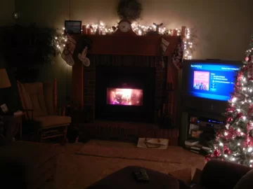

This is where I wish Woodstock would come up with a design. I have a ZC unit but I don't get the burn times others here do. It does however heat most my home pretty well and mine is just over 2000 sq ft. Here's a pick of it during the holidays.

They are both SBI fireplaces. I haven't seen one, but the Valcourt is reported to be a good unit. In your mild climate in a well insulated house I would not go too large. You might also look at the BIS Traditions CE and RSF Topaz.
For your climate I would stay between 2 and 2.5 cu ft.. Even then you might be opening a window at 50F outside.
