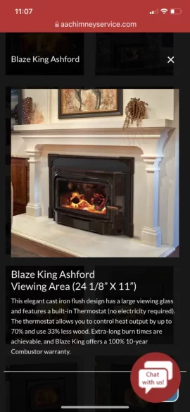

The dimensions I have are 31 high, 40 wide, & 24 deep. The blaze king Ashford looks nice.any clue on price?? Don’t really have any other ideas, I really like the open fireplace concept. Wasn’t able to find any open fireplace with those dimensions. Any help would be appreciated!

Tax credit is for stove/inserts with an efficiency HHV of 75% and up. All Blaze King stoves have catalytic converters in them. And meet this HHV value. Blaze kings are unique as they use a thermostat to regulate combustion air entering stove allowing the user to more rain set the heat output and burn time of the stove. To enable a really low burn rate they rely on the catalytic converter to “burn” the smoke and generate heat. Catalytic converters in stoves are similar to the ones in your car but need to be replaced every 10,000 hours and require different operating procedures to protect the converter. I am not sure how many inserts are available that are tax credit eligible that do not have a cat.
