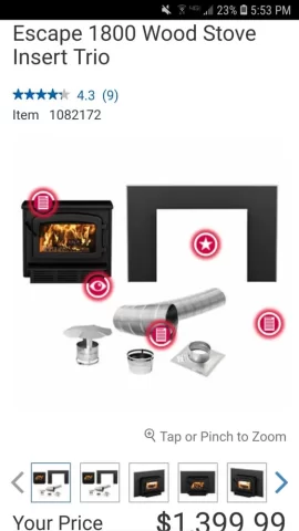

Yes, that is the one I recommended if you can work out a way to distribute the heat to your satisfaction.
I installed the the Escape 1800 6 years ago and it has been a great insert. Highly recommend it.
That is a great price too at Costco. I paid more than that for just the stove alone 6 years ago.
Thanks for the positive feedback on the Escape. I'm really considering it. I think I will upgrade the chimney cap and insolate the linner thought. I can do that and still come in for less than $2,000. I'm ok with that. Now just have to get permission from the war department :)
