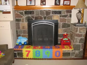

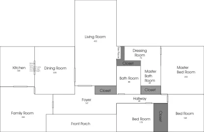

I have an existing masonry fireplace that has only been used a couple of times in the past 5 years, picture attached. It has it's own separate chimney/flue (not sure of the right terms here) than my oil furnace. I have a two story cape cod with a basement. The living space is about 1800 square feet and I'd guess the (concrete walls and floor) basement is another 800-900 feet. I don't know if my floorplan is considered "open" as far as fireplace heating goes. I attached a picture of it too. I know some heat will rise to the upstairs, but I'll be happy if I can just get most of the downstairs around 70 during the day.

Well, the good news is that it was easy to move :). We'll need some measurements on the fireplace to see what fits. Please provide front H & W back H & W and the depth at top and bottom .
I installed a PE Summit in my house. It's a 2400 square foot ranch and I live in West Virginia, a much warmer climate than yours. This is my first year using it and it's keeping the house warm quite nicely without being overkill. I have built some pretty good fires in it, so I know overkill is possible. I'm waiting for it to get really cold here before I do that again. Attached is my layout and so far down to the 20s outside and the heat is pretty evenly distributed. The room where the insert is located, is noticeably warmer but I like it that way. It will also burn all night on a load of wood, even if you sleep in. I have two tower fans I use to circulate the air and it works well.

First, I lied. The inside is lined with steel and but sounds like there is masonry behind it and it doesn't look like anything prefab. My house was built in 1947 and the original owner built himself and went wild with some things. I have a bomb shelter in my basement, for instance. ;D
I measured and here is what I got:
Front Height: 28 1/2"
Front Width: 37"
Back Height: It kind of curves down like my dormer walls upstairs--straight from the floor and about halfway up like a 20 degree angle to the top. 16" height on the straight part before it starts the angle.
Back Width: 28"
Top Depth: 17"
Bottom Depth 24"
Thanks, Karl. That's good to know. Your house looks pretty spread out, so knowing that the heat is flowing around is good. I think it was somewhere here I saw these little fans you can put in the corner of doorways. I thought that would be a good way to blow some of the heat from the living room with the fireplace into the my small hall so it can go upstairs.

Look into a PE or a Quadrafire if you like the plate look as both have thermostatic blowers as options.
It looks like the PE or Quad will fit your fireplace with little trouble.
