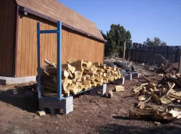

That's what I've come to conclude. Though I have invested in a blower, when I was naive and didn't burn hot enough. Now I'm hotter and coincidentally warmer, glad I'm building that new wood rack, I'll post pics when I'm done, prolly makin' a bigger deal out of it than it has to be, but hey..................
Edit; why not...............
  • [Hearth.com] Insert vs free- standing stove.............
