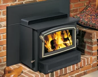

5 of the sides are enclosed by masonry and depend on the electric company to move heat.
Those sides are usually encased in an outer cabinet through which the hot air convects, not masonry. If the fireplace is central interior, there is little heat loss. The mass of masonry releases the heat after the fire has died down. Flush fireplace inserts are pretty dependent on the blower, but not all inserts are flush. There are several that convect quite well without the blower. Careful with that $20, we have several people reporting good heat from their inserts during a power outage. Some only turn on the blower during very cold weather. And remember, there was the Regency H2100 hearth heater which was very reliable for heating with no power.
[Hearth.com] Insert vs freestanding woodstove
The suck side of some freestanders is that they take up valuable floorspace and sometimes are awkward to place due to chimney location.
You can deposit the virtual 20 in my blitzcoin account.
