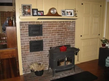

? If anything looks cheap and un-natural, it's an ugly sheet metal-surround insert stuffed into an otherwise attractive fireplace. I've seen a few folks make the best of it, but I can't imagine it ever being the preferred route.
<-- has freestanding stove placed in fireplace opening, looks natural

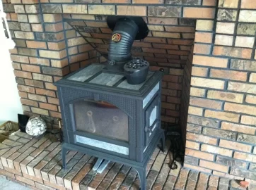

You would be surprised how small of a fireplace you can get a freestanding stove hearth mounted into. In my case the lintel is only something like 28inches high ( I don't have the measurement) and the hearth extension is very short, barely in front of the stove door. Yet the installers where still able to make the stove fit, pass clearance rules with heat shields and a hearth pad and pass the fire department inspection.

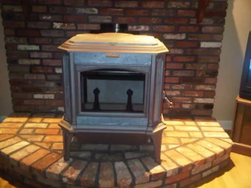

I had the same dilemma when I got my stove two years ago. I really wanted a freestanding stove, but my wife wasn't crazy about the look of stovepipe. So we compromised and extended the hearth a bit and bricked over the fireplace opening so that the pipe would not be visible. Here is a pic of our setup.[Hearth.com] Insert vs Freestanding

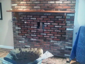

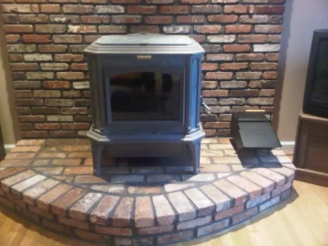

I've never been a big fan of inserts but sometimes they fit the bill if you have a small room and need a flush install due to clearance restraints. I went back and forth with my install and ended up with a stove with a modified fireplace.[Hearth.com] Insert vs Freestanding
I've never been a big fan of inserts but sometimes they fit the bill if you have a small room and need a flush install due to clearance restraints. I went back and forth with my install and ended up with a stove with a modified fireplace.View attachment 109624
Looks good Todd.
