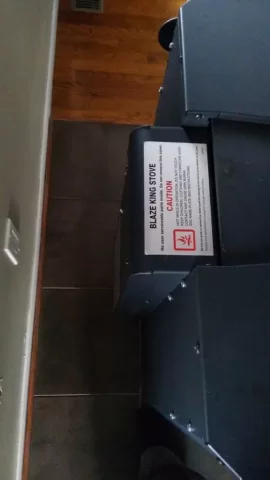

Well it's damp and cold here today and I got to thinking about starting a small fire to take the chill off. Which made me remember! I'm all set for this years burning but I forgot about one big issue I was gonna deal with over the summer. I have a Blaze King Ashford 30. Minimum clearance to back wall is 6". Not sure if you go from wall to back of the top of stove or the center part that looks like some sort of guard that lines up with the chimney but it's 9" to the guard and 11 1/2 to the top. The stove was installed in the spring so it's had some fires but nothing over an extended time. The wall behind seemed to get extremely hot sometimes, especially during the phase of cat engaged and thermostat wide open for 20 to 30mins. I plan on burning 24/7 over the winter and am hoping I've got good distribution so wasn't considering a fan, However if it will help keep the wall cooler I'll spring for it. Any thoughts on it? Do you think it will help keep it cool or should I be looking at possible tiling the back the same as the hearth or maybe some sort of deflector shield?
To the back of the stove the part that protrudes the farthest ( air intake square thing centered with the chinney). That's where the minimum clearance should be. My installer installed it measuring from the back of the firebox and that was way to close the wall was getting hot. This is after moving it.

Ok, so I'm dealing with a 9 inch space then. Is that enough room for a fan kit if that would even help? Is your wall getting pretty hot to the touch?

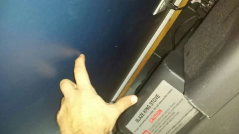

After spacing the stove correctly my wall stays a decent temp I have the fan kit. But even if I don't run the fans it stays OK. I think the hottest the wall gets is around 100

I should have lots of room for the kit then. I wonder if even when it's not running it's helping absorb some of the heat.[Hearth.com] Install a fan kit or something else?
It does add an air space so yds it will probably make a difference
