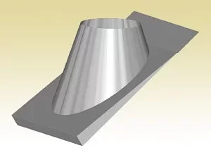

You'll want a metal flashing topside. Is this a composition or metal roof? Missing the storm collar and cap.
A proper metal flashing is more rigid, lasts much, much longer, better sealing and way less screw holes in the metal roof to secure. A good metal roof flashing is the one by Excel.
Flexible boot for metal roof is high temp silicone. Even then it isnt ventilated so I dont know how they get away with it.

Heat, sun & time. Plus I like a rigid chimney pipe install. A silicone boot has too much wiggle for my liking.
You'll still need a flashing which is the function of the boot. (and with it a storm collar and cap). Sealing the storm collar with a bead of silicone is a 2 minute task.
I used the excel flashing on my metal roof and it was easy to install. I agree with begreen it would be the way to go. Seems if installed correctly it would be less likely to leak as well. Now that I said that mine will start leaking. Lol. I’ve used hi temp flexible ones before and while it didn’t leak it didn’t offer any support and wasn’t any easier to install.
Some Excel flashing images. The last one is before the storm collar is on.
