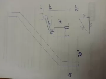

My husband is installing a Princess Blaze King in our basement. The only and best location has a drop ceiling tiles...floor to ceiling tiles is 83inches. He built a bit of a hearth that is 5inches off floor. Issue is he cannot go straight up as we are going through house (not outside house with the chimney) and if he goes straight up it cuts right in front of upstairs bedrooms window. So he will only get approx 8 inch rise before he needs to do a 45 angle. See picture.
Place we bought fireplace from says this is not ideal...and he should get rid of hearth...in the same sentence says those 5 inches wont do that much difference.
One of my husbands work acquaintances that installs all the fireplaces for the houses he builds says its not problem.
As well many others say its not ideal but shouldn't be a issue.
We don't want to lose hearth...it looks nice...we also don't want to put stove anywhere else. So is it going to cause problems having only that much rise from the stove and then a elbow right away...After it makes that turn its straight up entire second floor and through attic/roof.
Thanks

With a good slope and an adequate chimney above, that should be ok. It will work best with double-wall connector pipe instead of single-wall.

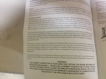

Please remember the stove must have 49" from stove top to ceiling. Please look at the overall height of the stove (3 Princess versions with different heights) add the 49" requirement and verify the clearance.

Awesome thanks, we have a manual...finally gave in and called Blaze King direct....they said there was some flack with a misprint etc in the manual...oy lol

The only thing that sticks out to me in my manual is a minimum of 36" rise from flue collar of stove before and bends[Hearth.com] Install question...8 inch rise?
