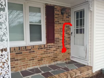

This proposed install location for the pellet stove venting is a no go due to the door correct? That door is not used and is a secondary door to the front.
[Hearth.com] Install question
I would contact you local code inspection person and talk abot your installation. Where i live the door would have to be removed and wall rebuilt. Not to mention the window is close too
Possibly up through the ceiling & roof.
Thanks for the replies, that is what I figured, opening window within 4ft and the door is icing on the cake. Might have to look at a wiseway since it has a top exhaust.
