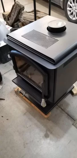

Getting ready to install this 1400 in my up north man cave. I stripped and repainted the stove. It came with about a 5.5 foot peice of double wall pipe that telescopes. This telescope pipe will not reach my 10 foot ceiling. Can I come out of the stove with single wall then switch to double wall stove pipe up to the class A? There are no clearance problems with the single wall, I just want to save money and reuse parts that I have. Only paid $250 for the stove and double wall pipe...

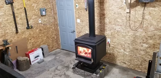

Had the stove setup for a few weeks now, works awesome. Finally got the time to post a picture today. Was supposed to be out riding ATVs but its cold and rainy although that usually doesn't stop me...
