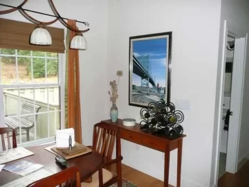

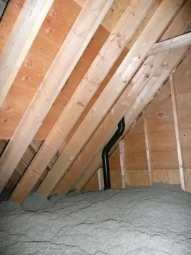

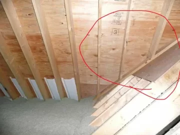

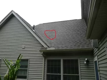

OK, here it is....
about the only place in my house where it seems possible to install a wood stove - something like the morso with the close (8 or 10") clearances.
You can get a visual by seeing where those two windows end on the outside (left side) - and inside (right side) - the stove would be in the place of that 3 drawer table.
What say you all? Is this just too tough, and I should stay with the gas fireplace and pellet unit in the shop? Or can it be done fairly easily? This is the rear of the house, so not too much concern about the pipe extending high on the outside.
Plumbing vent shown from inside is also visible from outside (for reference)

It will be just like any other through the roof install with more cutting, measuring and planning :)
You're going to have to go pretty high with the chimney to get the 3' / 10' rule arent you?
From a structural stand point there is nothing wrong with that. You are far enough away from the valley to worry about any leaking.
Looks like you'll have to offset the chimney once you get into the attic. Other than that looks like a typical install. With that snow slide and being that far down from the peak maybe some sort of ice dam would be in order to divert the brunt of the snow from the chimney. Last year we put in a Sequoia down hll like that. Told contractor that some sort fof diversionary device needed to be installed when they put the roof on a week later. 2 weeks and 2ft of snow later we replaced a bunch of smashed chimney. Some dense packed duratech or the like would have fared alot better than the SUPER HIGH QUALITY majestic chimney but would still need that dam in my opinion.

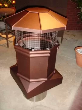

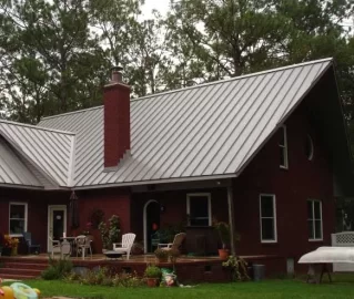

As if he was reading my mind, a customer just sent me pics of his extendaflue on a tall chimney with a steep roof.
See enclosed......
Looks pretty good - that is something like a chase would look like around mine.

Yeah a chase would definately be a great idea in this situation. Aesthetically and structurally it would be the proper solution. I'll have to take a picture of the extendaflue that we put in here in Casper. Not a great looking house or chimney but it looks alot better with the extendaflue. There are some old houses downtown with some shabby home made caps that are begging for the extendaflue treatment.

Your fine at that spot, as long as you can get your way through both sets of rafters. Try and keep it as far from the valley as possible. Just don't go through the valley.
I'd say stay at least 12" + away from center of valley. And don't skip on a nice size flashing pan. I personally would rather go taller on chimney than offsetting if possible. Thats just my opinion of course.
See enclosed......
Beautiful house & same for the metal roof. Notice metal roof........... not gutters. Smart homeowner.
